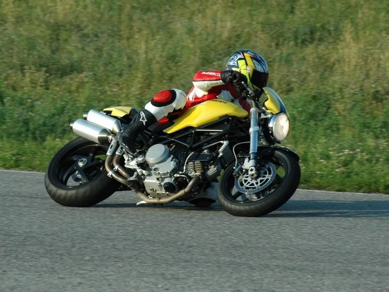

I absolutely love my S2R on the track.
MikeB is correct on alot of things. Some of the riding style needs to change when using the mx style bars, I was contemplating getting clip-ons until I bought the 749 as a track beast. I never found any problems with how the bike felt other than wanting clip-ons and then some rear sets to tuck your fet back better. The one thing I was always scraping was the kickstand, but if she's a track bike then yours would be removed permanently so now worries.
I am a picture whore but you can tell she's capable of hanging in there ;)
Yeah, from a performance standpoint the S2R is a pretty fun bike on the track. Other than some minor ergo changes it works well. And as Stasher demostrates even those aren't necessary if you change your riding style a little bit.
