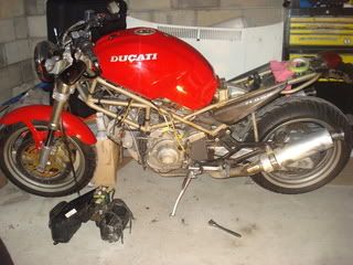

Well i only have ridden it once and that's when i bought it. other than finding a carb'd 900, the other hoop i had to jump through was the fiance. i really glad money talks cause i had to pay her off the get a bike. but you know what i don't think i could have ever been more happy with buying another car than my new other girlfriend. the bike. haha. i have a lot of work and money to happily spend on my baby. well i wish i could have gotten a better before picture, but i was too edger to start refreshing and fixing almost everything.

Big F**kin To Do List
xhelmet(bell star)
-jacket
xbar end mirrors
-new plugs
-plug wires
xfuel filter
xfuel hoses
-check valves
xk&n filters on carbs
xemission delete
-install aluminum flywheel
-dry battery
xnew batt. box
xrear height risers
-chain
-oil change
xcase saver
-f & r sprocket
-new instrument panel(torino)
-superbike kickstand & bracket
-seat cowl or mono seat
-mono rearsets
-clean and seal tank
-bleed r. brakes
-plate relocate
-r. turn signals in frame
-fork
-clutch assembly
-wheels
-powdercoat frame
