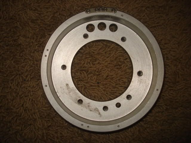

i picked this up on the cheap. it has label on saying it fits 95-97 2 valve monster. but since i haven't seen one in person i don't have anything to go off of. i could only try and compare it to the nicholas flywheels. the newer and older carb'd ones they sell. i have a 95 m900.

it looks like this one, from Nichols

looks very like the one off my 1995 M900 although mine seems to have strips welded on the flywheel edge to trigger the ignition.

i believe it may work. looks to be correct from the haynes manual. i already bought a new cover gasket. the only thing that picks my noodle, does the left cover have oil inside? i know it seems like a dumb Q, but having the ignition triggering components, alternator, and flywheel in oil seems very odd if it's true. i haven't found any concrete evidence to answer this.
